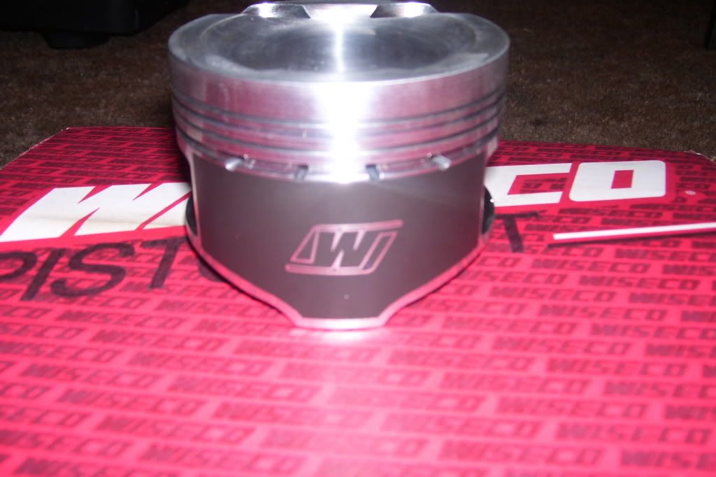

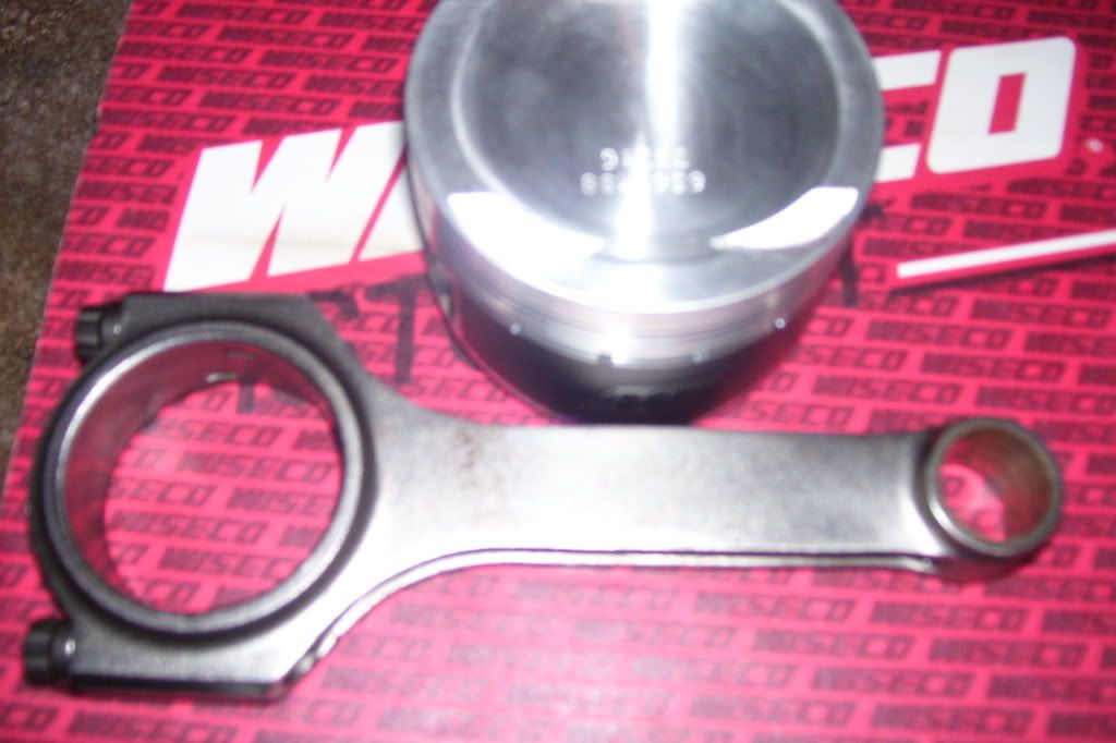

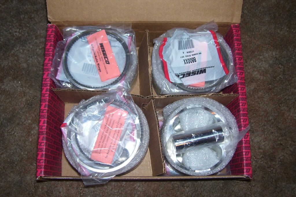

Well, I am starting a build on my SRT 4. I don't want to hurt a stock engine again, so i decided to build an old block I have lying around. I tore the block down and found the cylinder walls to be in perfect condition. None the less i opted to go .020 over with a custom wiseco 9:1 dished piston. i will also be using Eagle H-beams. Why 9:1 ??? because i want to be able to build more power on less boost. I don't want to run the ungodly amount's of boost people run in these cars. so 20psi should do the job as a high boost setting with the 9:1 .020 over pistons.. i will keep this thread updated and adding pics of my progress....
My psitons arrived today, have had the rods for about a month now.

UPDATE:
Got some parts in the mail, also got my block and crank back from the machine shop.
I cut my rings to .019 and installed them, also got my rods installed on the pistons. All i am waiting for is my main and rod bearings to come in, then final assembely
