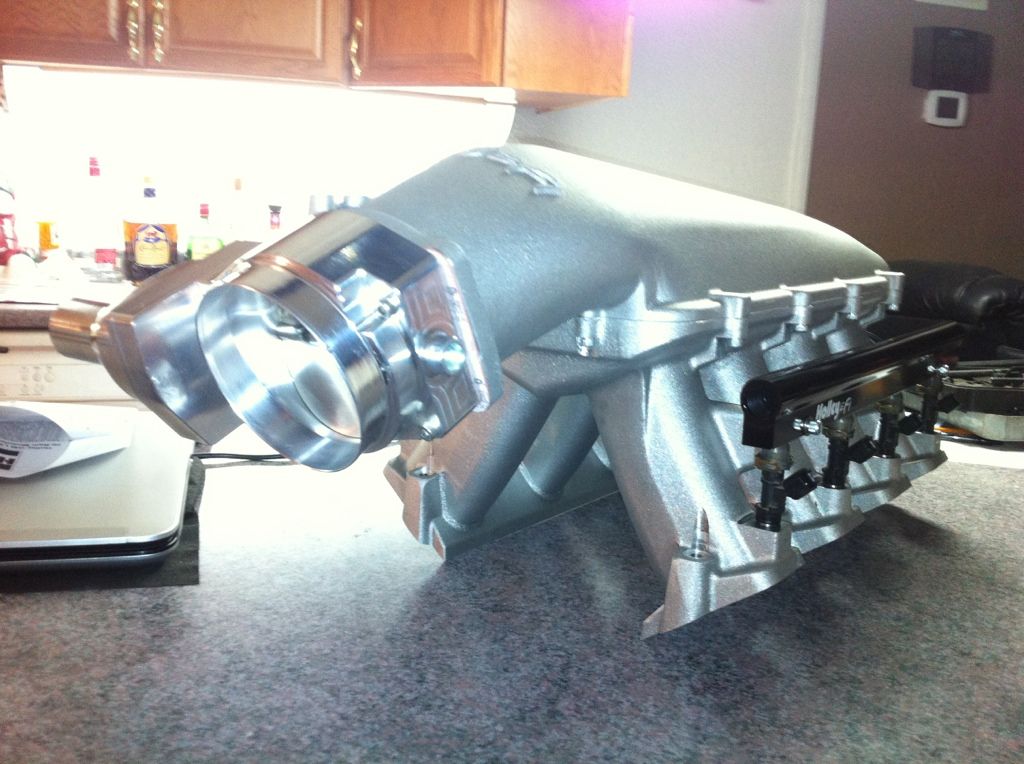

What's up guys? I know some of you are saying "TX2K14 is one year off!" Yes I know, but this project may just take all that time. Who knows! Anyways I decided to post up over here and on PT.net to get a good deal of advice and opinions here since this will be my first turbo build.
Essentially what I'm starting with is a 2007 Chevrolet Silverado crewcab 4x4. This has been a project truck of about 5 years now between my dad and I. I'm moving away from the supercharger scene because, well they're just inferior to turbocharging as was proved with my recent experience with Kenne Bell. (Couldn't make enough power, and couldn't keep the air-charge temp cool at 20+psi)
I'm also getting away from the aluminum LS motors and moving on to the iron blocks. Essentially what we're aiming for is 1300AWHP at 26-28 pounds of boost. SO, underway from LME right now is a 427LSX shortblock, with a Callies Dragonslayer crank, Callies rods, and a custom set of Wiseco's with heat treating, gas ports, and a .210" wall pin. CR should be about 9:1 with my large chamber heads.
Essentially I'll be running a set of 4 bolt Cadillac LSA's done up by WCCH and ARP 2000 LSX studs. If it pushes water, well that'll warrant some 6 bolt LSX heads but for now I think it should be fine. I'll be pushing the ID1000 injectors I have now until they scream Uncle, and I bet that'll be somewhere around 20 pounds of boost. Should be fun for long enough to let both mine and my dads bank accounts recover.
Haven't had time to spec myself out a cam yet, but I'll probably be doing that here soon. For intake I'll be running a Holley Hi-Ram with a 102mm inlet for the big TB.
I also haven't figured out which turbo kit to go with, but I have decided on a Garrett GT91 to do the dirty work and a big A2A plus some meth. :boobs:
Besides all that crap, I'll be doing a full fuel system upgrade to -10 feed, wiring cleanup, gauges, AMS1000 converted to manifold pressure instead of CO2 reference, and all the other goodies. Hoping to go give a couple of fast guys a run for their money next go around.
I'll be posting lots more info and tons of pics as the ball gets rolling, so feel free to share your thoughts and insightful commentary but at the moment I needed to get a thread started so I wouldn't be too lazy to do so later. Enjoy!
