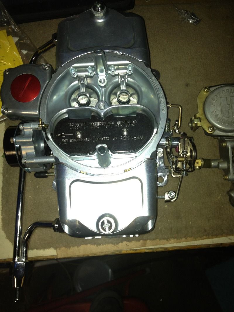

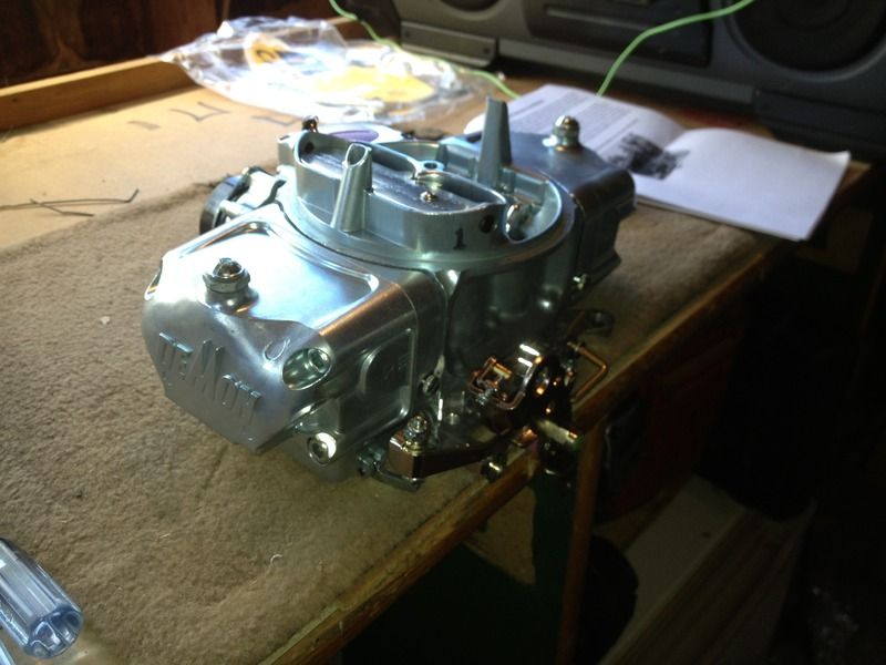

Couldnt keep the car running very well, Every time I put it in gear, she died. If I was able to get in gear she would die after. It was a pain. Finally I ordered a new Carb. A Speed Demom 650cfm. She ran great, fired up easily, stayed running.
A buddy moved back to California and knows more about mechanical work then me. I was researching rebuilding the stock 360. He convinced me to change my plans and the new engine build has begun. Budget is still limiting the speed of the build, but steady forward progress is being made.
6
Couple pics of the Demon

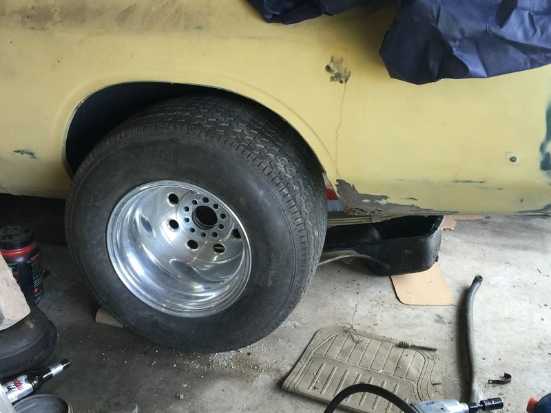

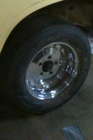

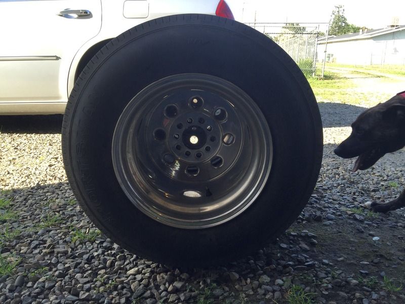

Second change. Wheels. I like the wires(look). I hate the size. If i could find them/afford them, I would have offset wires, with nice wide wheels in the back. Came across these
4

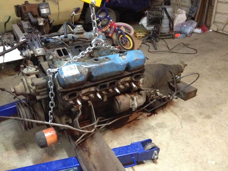

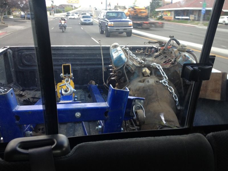

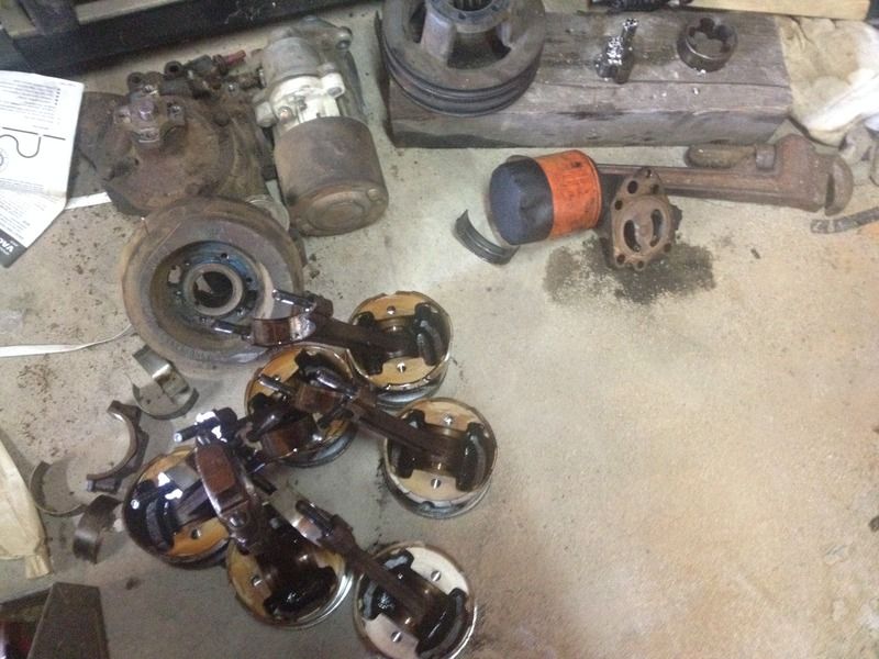

Main change in plans. My buddy Mark talked me into going to a big block. I found a 440 Motor and tranny for a fair price. Drove to Reno and picked it up. Didnt look like much. Has potential. We also had all the stock parts we could get, alt, distributor, motor mounts and much more.

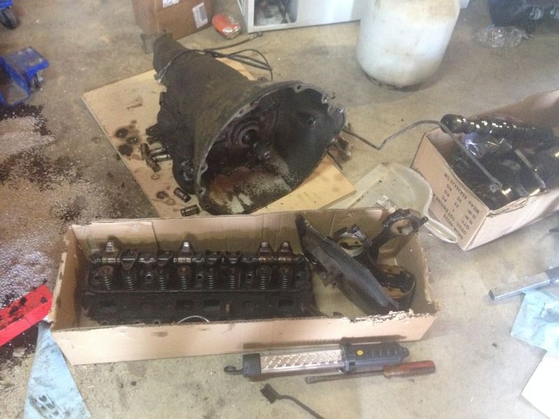

We began tearing it down.
Then it came time to begin the rebuild....
4

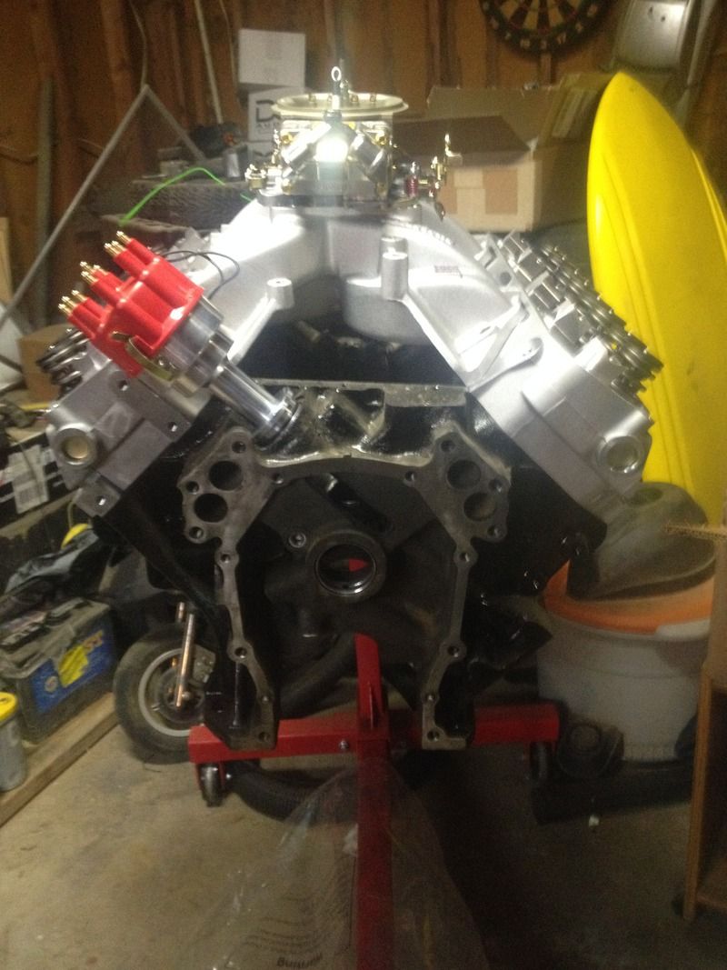

Ok, Motor plans. We decided if we are going to rebuild a motor, we should just go big instead of a basic rebuild. On the downside going big cost more and this is my very first engine rebuild. I am learning a lot as we go.
:money: :money: :money: :money: :money: :money: :money:

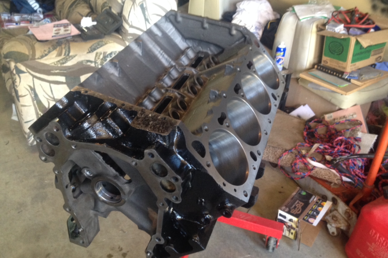

took the block in and had a shop work it over and bored .030 over

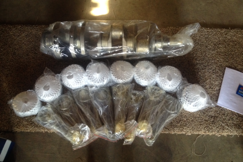

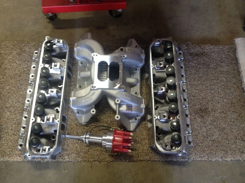

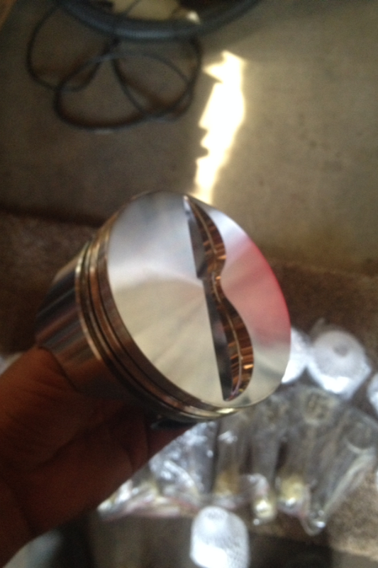

Ordered a all forged 528 stroker kit. Flat top pistons.
Ordered aluminum "stealth" heads and pro billet distributor from 440 source, and eldebrock intake, just came in.

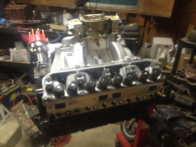

The heads complete and "ready to go". I will probly have to change out the springs depending on how high a lift cam I go with.
The way everything is now, puts me at 12.1:1 compression ratio. Still concerned about that being a little high. I want to keep this on pump gas. Some of my research shows that I may need to run a water injection kit to be able to run pump gas. :(
The more I get in the more excited I am to get this back on the road. Next up I need a cam and carb. Still researching. Any recommendations would be great.

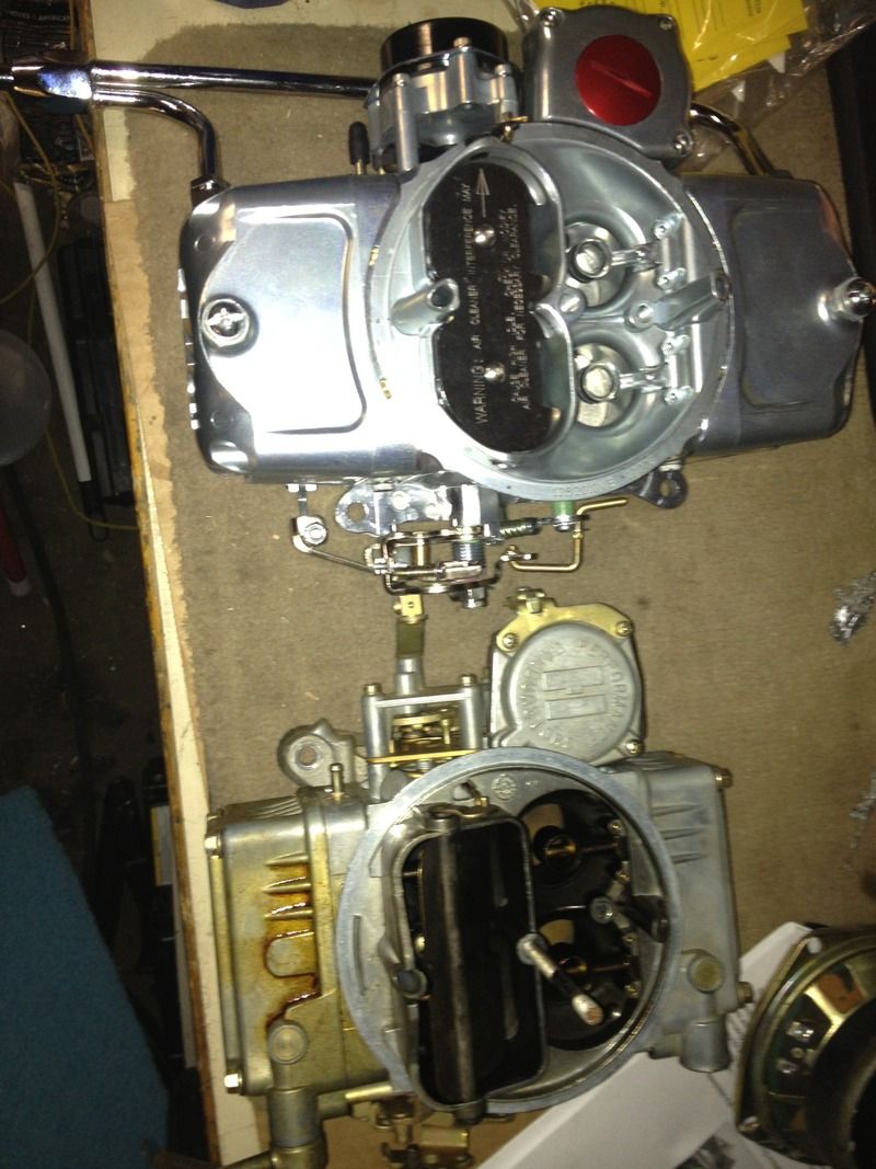

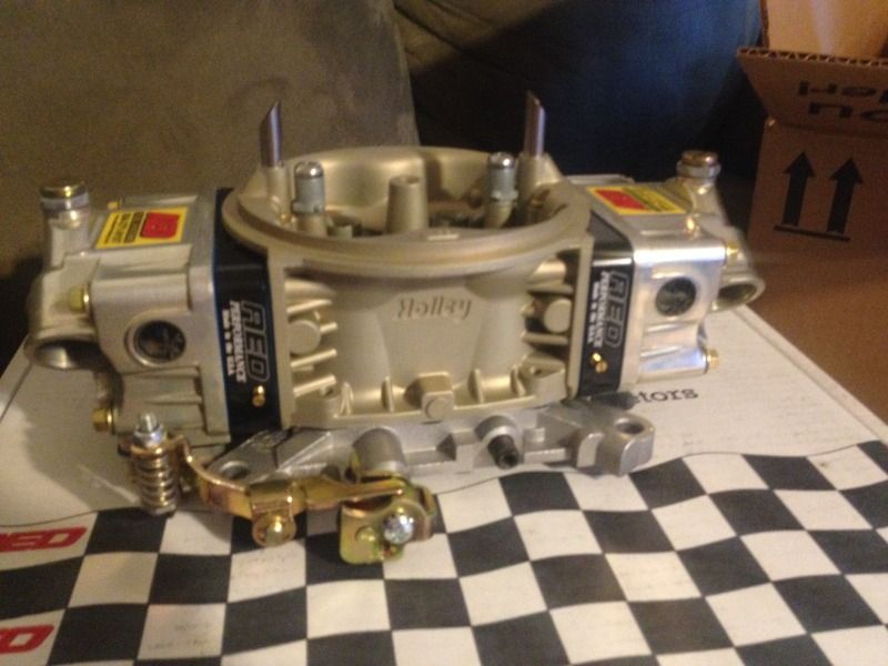

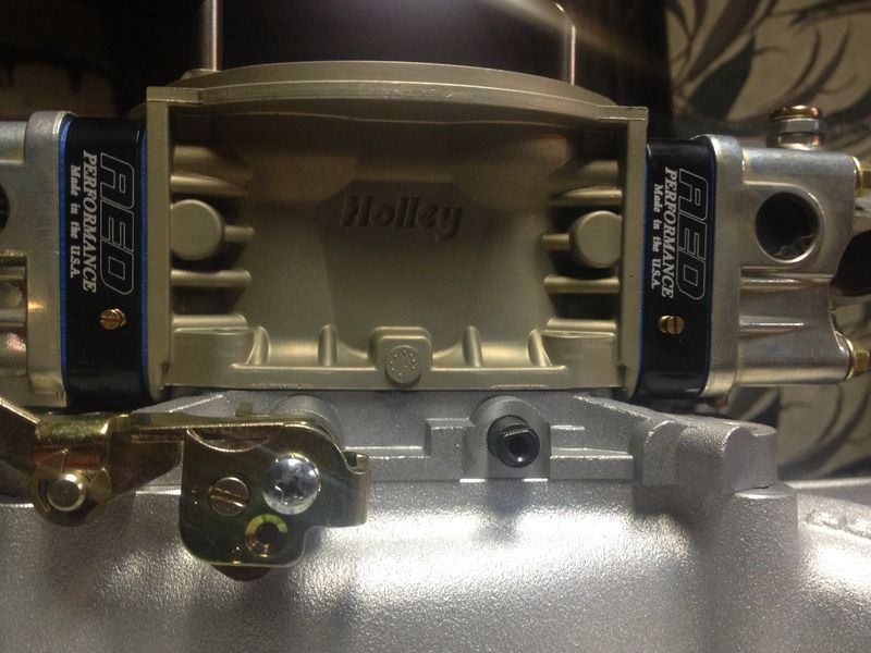

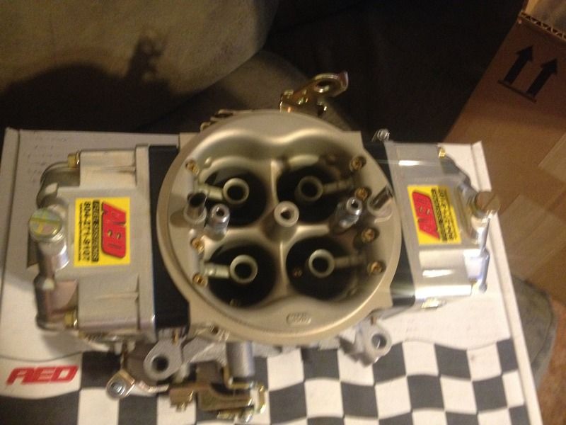

so finally ordered the Carb. Its a Holley HP modified by AED performance 1000 CFM.
SO I had to place everything together to get an idea of how it will look.
Very excited. Cant wait. Few more parts to order.
This thing should make some good power.

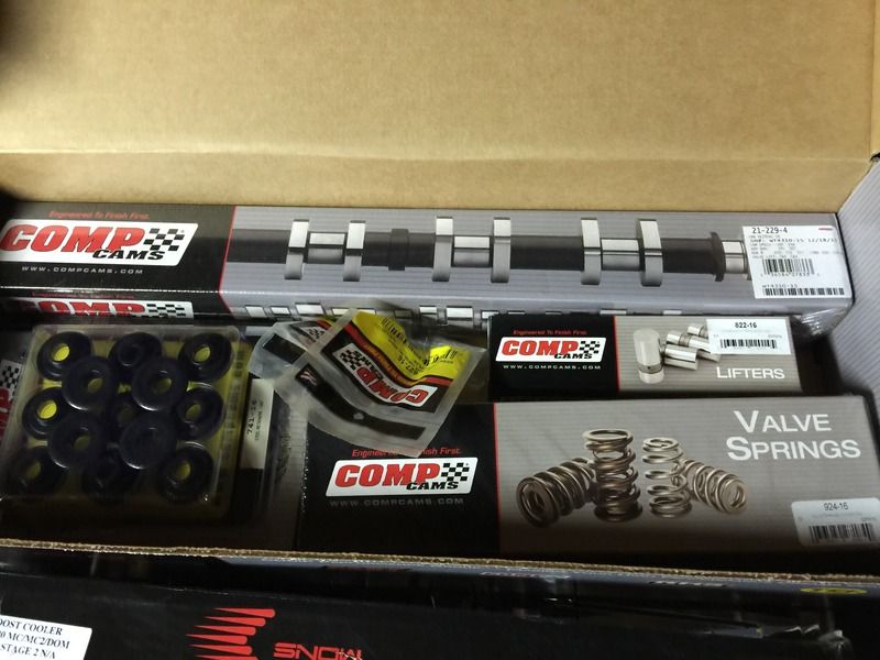

I am shopping for a cam now. I sent request to a few big cam companies for their recommendations. Comp cams replied with their Xtreme energy 21-229-4. Over the last month or so I sent 3 request to Lunati, with no response. Couple days ago sent one to Crower, no response yet. Dont want to get the wrong cam. Still waiting, but will order soon.

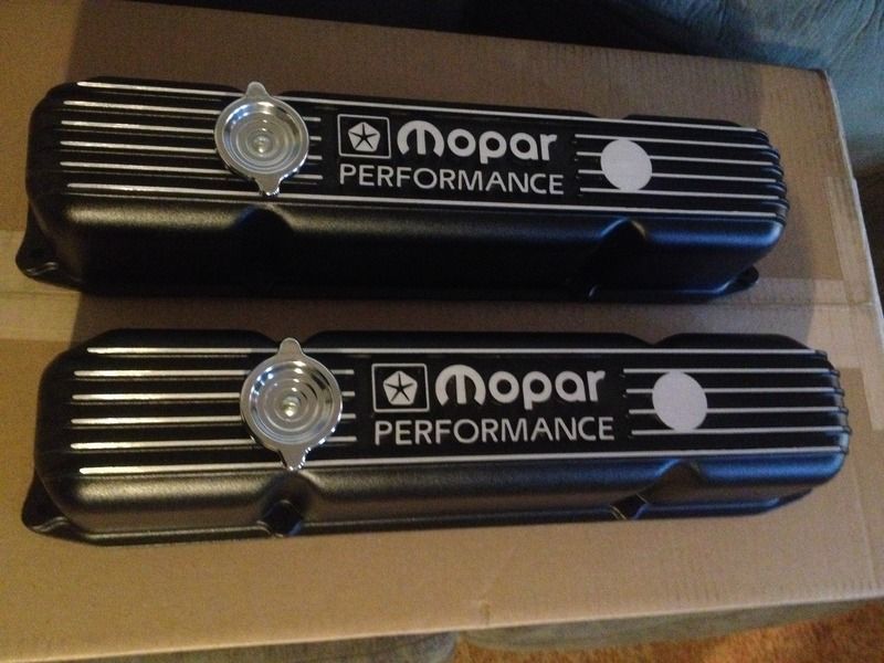

Did order the Valve covers and valley pan.
Slow progress. hopefully after Xmas it will get more momentum.

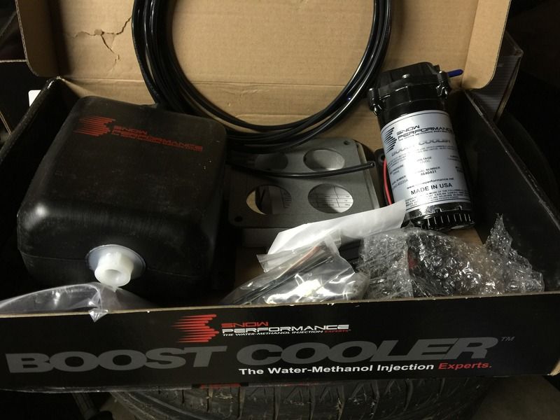

Back at it. Some more goodies. Went with comp cam extreme energy dur 295/307 and lift .564/.564
Snow performance water-methanol injection.

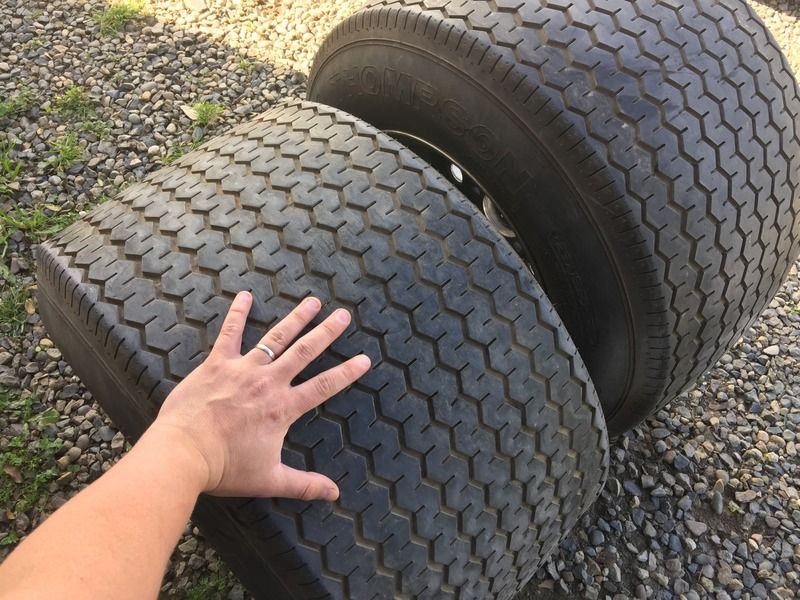

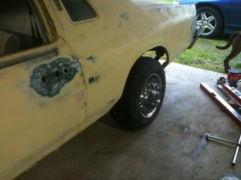

So I have made another change to the game plan. It will require more work to make em fit.....
Got to do some work to get them to fit.
