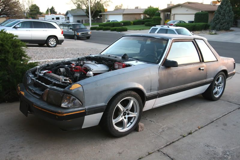

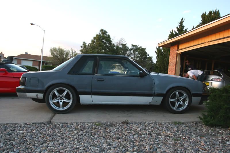

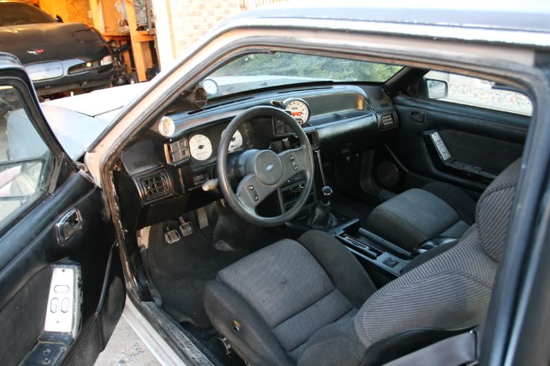

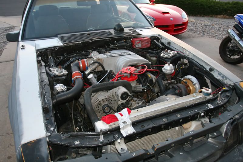

I finally got one, its been a few years that Ive wanted a turbo foxbody notch. I came across a deal and had to jump on it. Its not what I originally wanted way back when but it will work. Its ruff around the edges, needs some work but I think its got potential. I am going to see if I can get into the 10s for under $5000-6000 total investment.
Here is my plan of action. Get the car running right, its pig rich and dies after you get on it a little. Swap out those 4:10s for anything, well not anything but almost lol. Chevy power glide tranny with a brake of course. Trade the 98 cobra wheels for some drag lights. Take out weight where ever I can. Get some nice paint on it (This should cost me nothing and Ill learn a little about painting a car, Ive always wanted to learn)
Here's the skinny.
1989 Ford LX coupe
5-speed T5 glass box tranny
DSS 306 but with stock heads and intake mani
Cartech intercooled turbo kit with ITS 76mm turbo, Tial bov, Tial wastegate
Aeromotive fuel pressure regulator
Lighting maf
42 lb injectors
70mm Edelbrock throttle body
MSD 6AL box, distributor, coil, wires
tubular K-member and A-arms
Coilovers
5 lug conversion with moser rear axles
98 Cobra wheels
8.8 rear end with 4:10s OUCH!!!
Now some pics.

I wanted that car so bad! I almost bought it. If you need a turbo for it, Ironman is selling a nice one. Congrats on the car, that price was a steal!

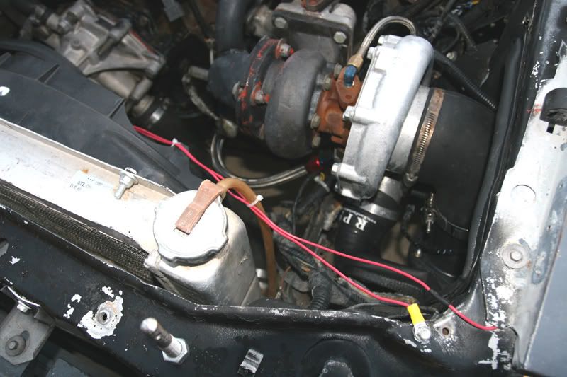

This turbo is a 76mm ITS so it he was telling the truth it is a good turbo. The exhaust housing looks small but it says .81 AR.
· Ex-Nazi
2,214 Posts
Your BOV is in the wrong place and/or not recirculated, that's why it dies after you get on it.
