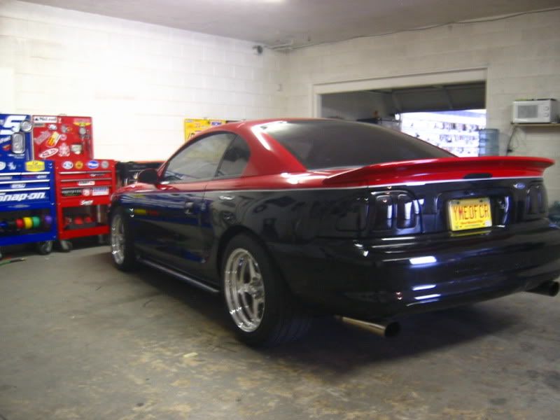

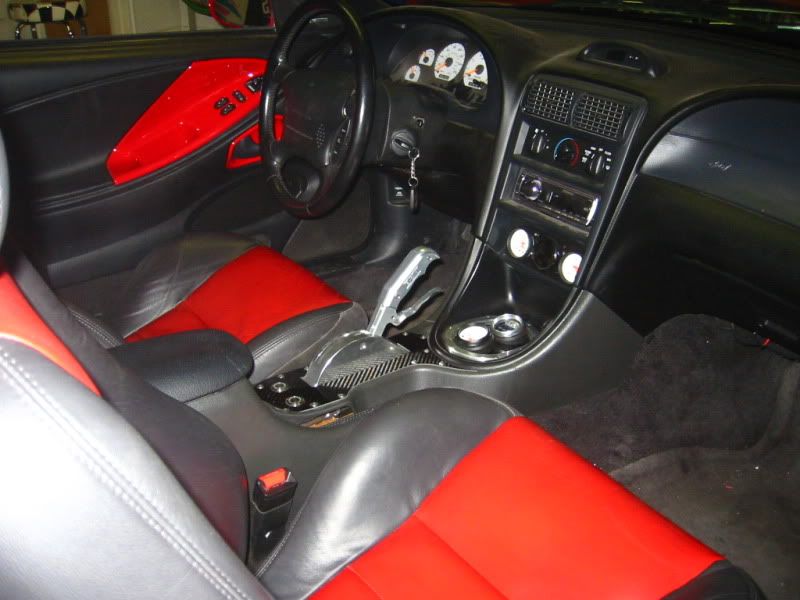

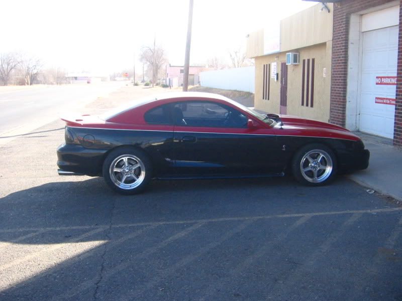

Just Got the car back from the Dyno Edge, where it recieved a few parts, rearend, lentech 4r70w Auto swap, Tune, etc. Big thanks to Chris, car drives awsome, made 500 rwhp on 16 lbs pump gas thru the auto.
I have been building this car over the past 2 years and its almost done. (Not much I haven't replace) But I will post as the build progresses I have my eye on some 6 piston wilwoods, and shes gonna get a stereo next.

Custom console shifter mount
Billet OD and Trans Brake Buttons
