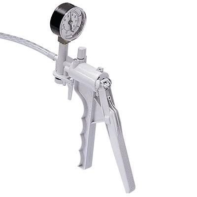

I own a 2002 Mustang GT and I'm having a hard time bleeding my brakes. I recently did a brake swap, i put cobra brakes on the rear, I got this from a 2004 Cobra, I got the brackets, rotors, calipers and brake lines. I started doing the standard procedure i read online, sequence: passenger rear, driver rear, passenger front, driver front. So I had a person in the car pump the brake pedal 5 or 6 times, then hold the pedal down, while I open the bleeder valve and fluid and bubbles would come out, also I've been refilling the master cylinder to make sure there's fluid in there, so i did that for a while without any luck. Also I bought one of those brake bleeding kits shown below
