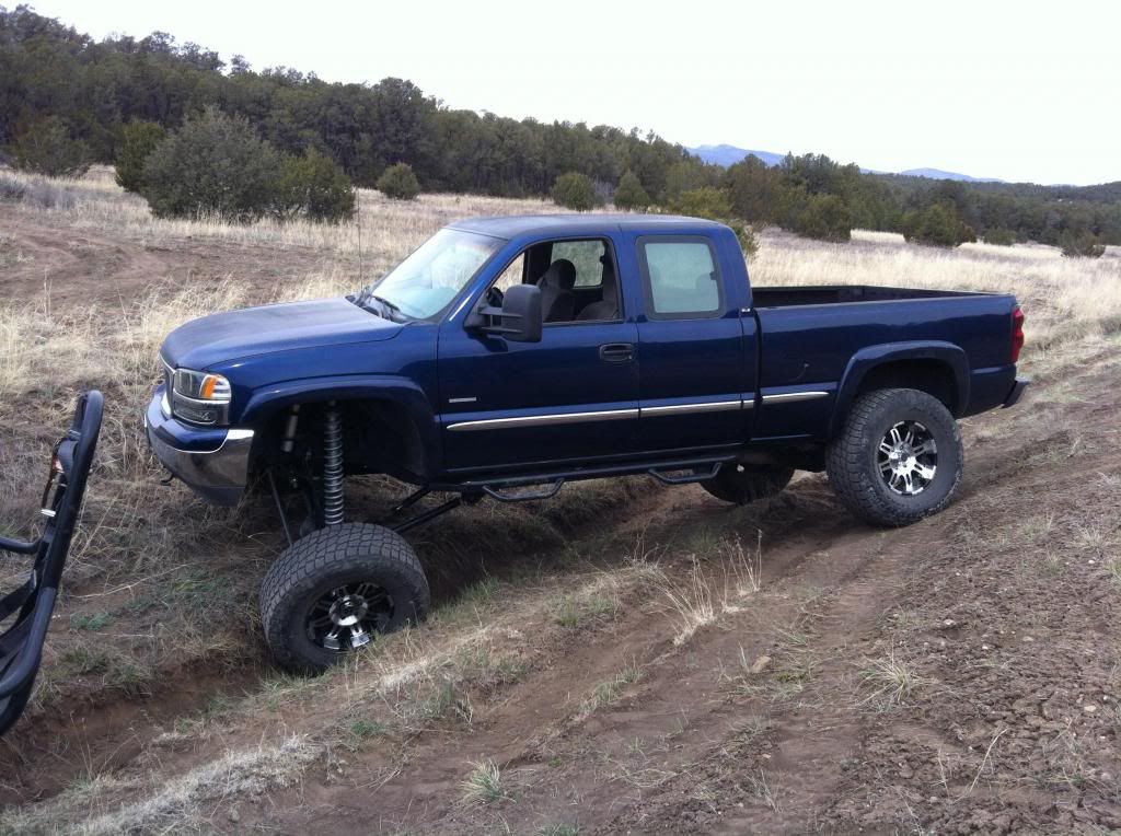

Ok guys, today was the maiden voyage of The Smasher. It still needs some tweeks and adjustments, replace 2 of the springs, and a few other things, but im real happy with where its at right now. Heres some pics of what we did today. First was the hoops, then hanging the coil overs and putting it on its feet. Gotta give it up to my buddy DJ. Couldna done it with out his amazing fab skills.
51 inches on 31s. Before the fenders measured at 49 on 37s.

I finally finished this up the point of wheeling. What do guys think, do I have some flex now?

Jeeze that is some crazy suspension right there!!

It has some body roll, but handles really good on the highway. I don't mind it. Still rides like a truck

If you dont mind me asking.... around how much did that run you?! Looks good! I've been wanting to straight axle mine for a while now.
I'm somewhere in the neighborhood of 5-6k. It was a lotta work, but worth every penny
