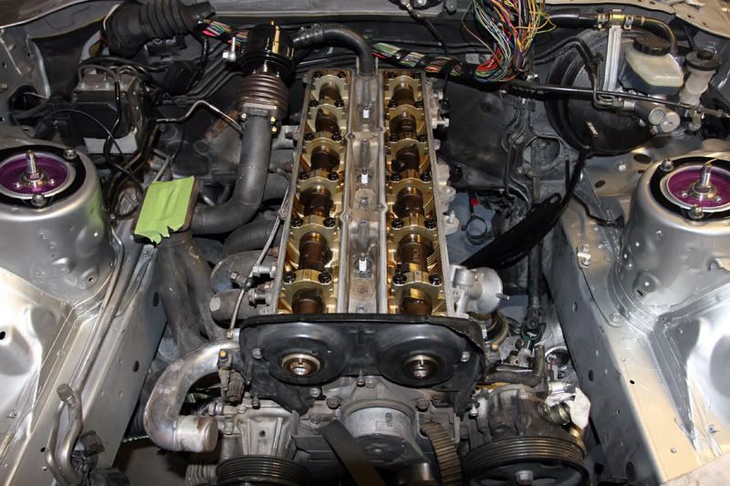

Ive got some weird problems going on. I just recently got my car running after doing some work to it. Here is what I did. Replaced lots of seals ect, installed HKS 272 cams, added PHR valve springs, and some wiring (relocated my fuse box to back of car).

Could the HKS cams cause this boost creep? If it can it still does not explain why I cant raise the boost with the boost control. I am out of ideas of what to check or what it can be. I might try and get my hands on a manual boost control to see what it does.

The boost creep I think is caused by the more flow I got with the HKS cams. Here its only creeping to 1.3 so Ill deal with it later.

It is the cams. The more power (air/fuel) the motor is using the more the flaws in any system will show their ugly head. I am thinking its the wastegate/manifold. My integra would do the same thing on low boost. Larger turbine housings tend to do the same thing., wen teh gate/placement is not the best. It is easier to go through the turbine than the gate on lower boost. The car would make 11 psi creep to 14 on the 7 lb spring. but at 24 psi it would hold steady. That's my theory anyway.
