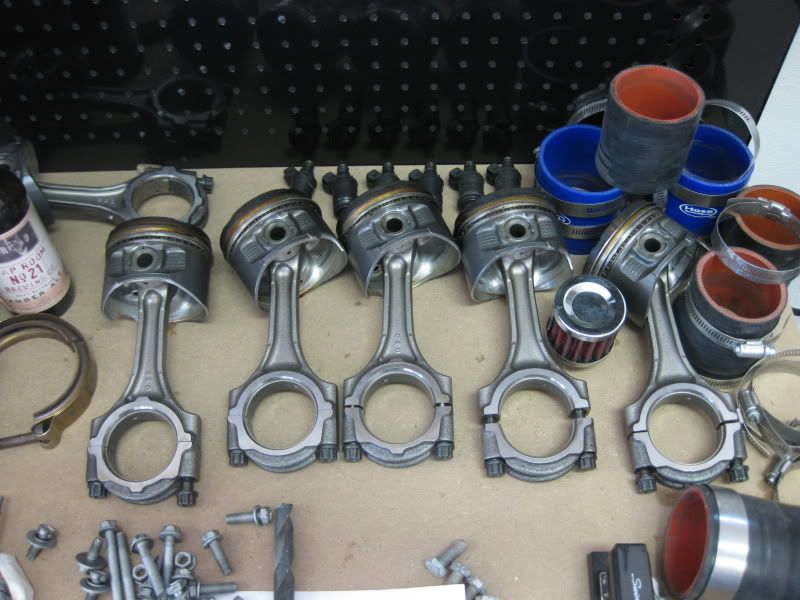

In the process of building the IS300 into a "True Street Car" ;-) The old set up made 450ish whp, hoping the new set up will make 600whp on pump gas and 850ish on race gas.
Here is a few of the new parts going on,
Precision Billet PT6765S 0.81A/R Polished
HKS DLI
CNC Dual Fuel Pump Hanger
2 Walbro Fuel Pumps
Kelford 272 T202-C Cams
Manley Springs and Ti Retainers
Supra GTE style Intake Manifold w/85mm TB polished
full fuel system Lines and regulator
GE Head Street Port Job
All New Valve Seals
Haltech E6X
HKS cam gears
Polished Fuel Rail
Volk GTS wheels F 8.5 R 10.5 (245/285 tires)
Supra GTE internals
New oil pump and seals
:headbang:
auto to manuel swap
Supra V160 transmission
RPS Billet twin carbon clutch
stock supra 6 speed shifter
Larger IC and piping
Here is what has been upgraded so far,
Stance 15 way damping adjustable coilovers
Stoptech 4pot BBK 355mm rotors F, gonna do R in the future.
I didn't put the rotors on cause Stoptech sent me the wrong style. Below is just a mock up to see what the calipers are gonna look like.
Here is a pic of the stock size rotor next to the new ones
Stock caliper next to the new one
clutch peddle installed, auto shift assembly removed
Just need some time to finish/work on all the other stuff! This is where I'm at now. Most of the old set up has been removed at this point. I may relocate the ABS and battery to clean things up a bit. Still waiting on most of the other parts. Inputs, ideas, and suggestions welcome.
