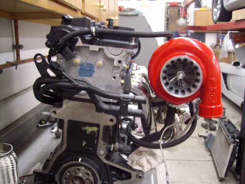

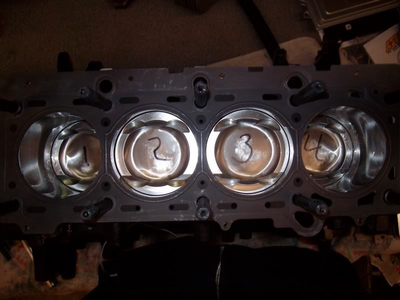

Just joined, thought Id share what I've been up to. Used this for my daily while in school and working full time, paid it off, parked it for a while. Worked for a close friend of mine here in St.Louis at his shop JMB performance. Anyway, got bit by the big after building some nice cars/trucks and decided to make one of my own. Ill save the build list because its long, boring and its still a neon right? haha. Short run down: .040 block, wisecos, crower rods, t04z 67mm, 2 stages of n20, 2 stages of meth, bunch of other junk. Built to be a streetcar. Dot 235 M&h's, pump gas, no cage, full interior no weight saving. Not sure on what power its going to make yet. Should be upper 500, low 600 with the boost in the upper teens. Big thanks goes to the owner of JMB for all of his help and insight. Thanks for looking.

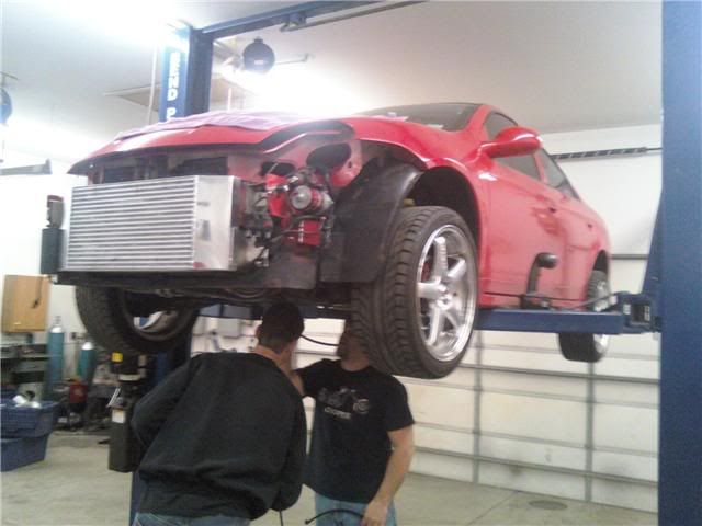

Im used to the neon hate. There are about 3 guys in missouri with srt4s that I will talk to, the rest I avoid like the plague. Thanks, I like how the intercooler turned out.

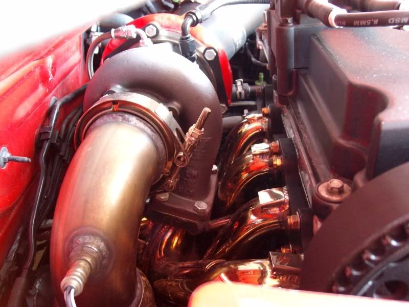

Sweet. What ex manifold is that?
DNP. Was trying to cut corners a little at the end to stay in budget, went for it instead of the AMS manifold. A well built piece but a total PITA to fit the WG and downpipe.

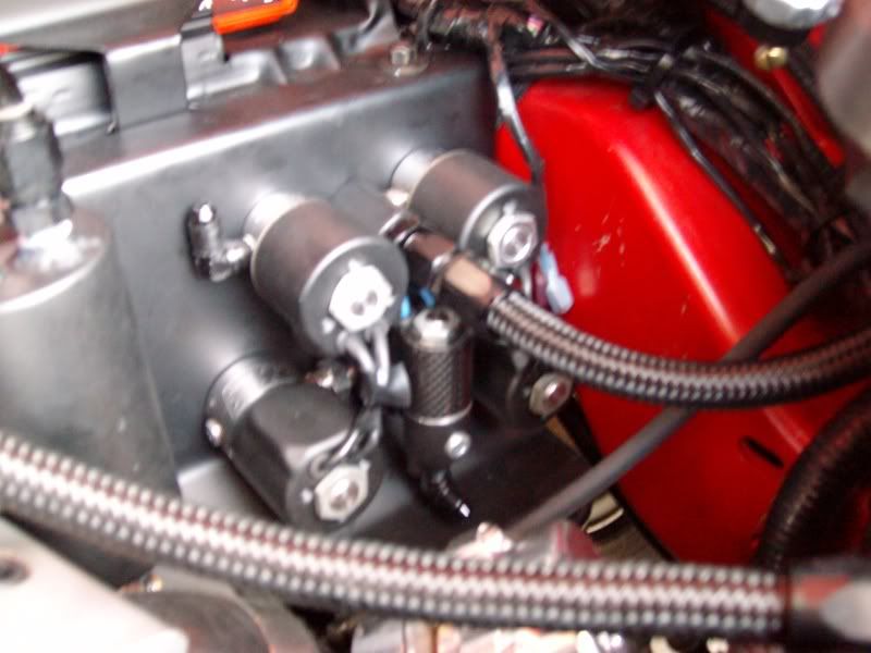

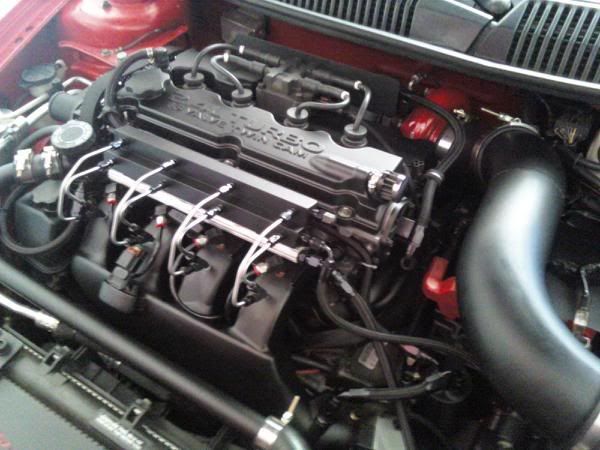

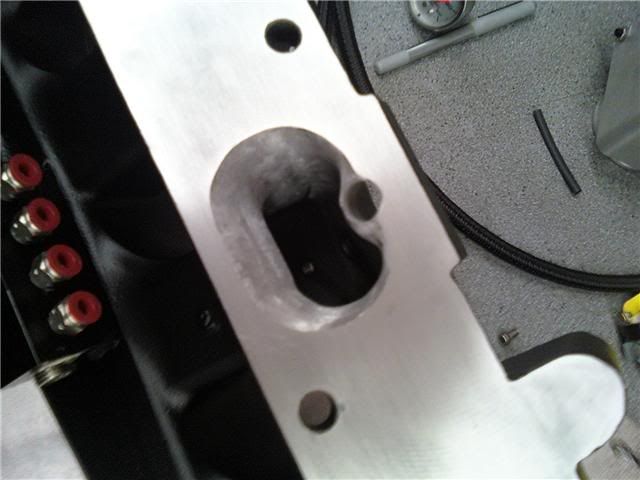

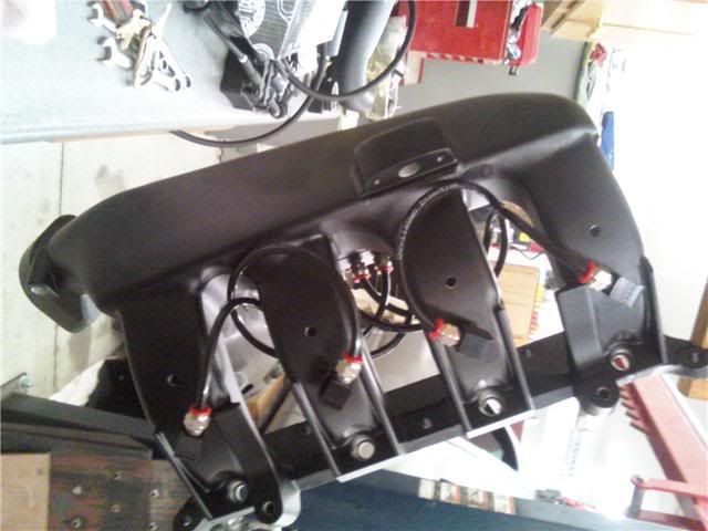

Thank you. Other then all the -an fittings and line my favorite is the intake. Thermostat housing has been cut and clocked 45* to leave the #1 intake runner clear for the n20/meth,then I made the n20/fuel manifolds on my grandpas lathe 17.5 5/16ths bore was tough on 1"/1" square stock, love how it turned out.

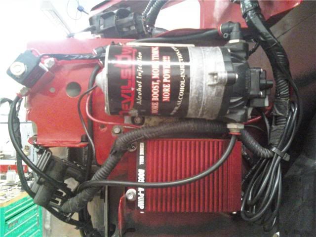

thank you, Ill post some vids and stuff after I finish up the fuel on the n20. They don't make black line that will take the pressure and I spent too much time trying to keep it all black, just I finished up spraying some stainless line flat black litterally looks exactly like the nylon hose, going to install the black fittings tomorrow and shes ready to tune.
